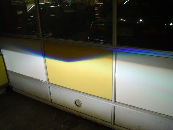

Some pics:
Here is how the cut off is supposed to look like:
I noticed that my HIDs look much better (and crisper) in my 97 than they did in my 99. Just a thought...
looks better than my patteren :(

not sure what you are asking. If you just install the standart HID kit sold all over into our halogen non-HID housings, that is not exactly legal because it creates the glare (see above in a 1st gen stealth) which bilnds the drivers. In order to avoid the glare, people put HID projectors from vehicles that come with HIDs stock into their halogen headlights - that is called retrofitting. Did I answer you question?
