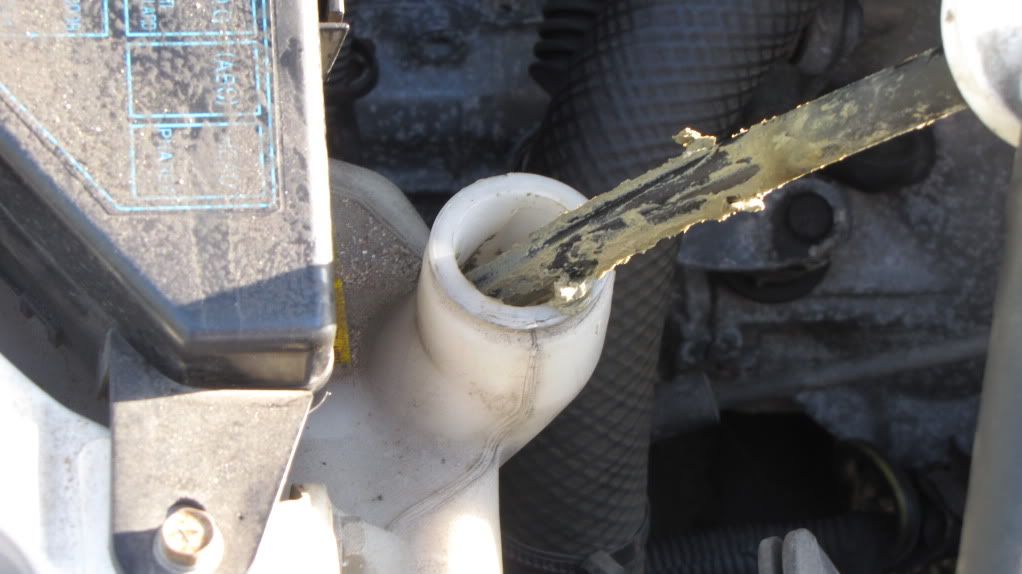

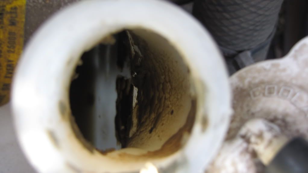

Please help my car needs this pretty bad my reserve tank looks like 2 girls 1 cup:

Man your system looks bad .
Do that flush and then pour one of those flushing coolant bottles on it, drive the engine and then flush again, i wouldn't do it with just water.
and this too LOL!
looks like oil contamination more than anything els. what does it smell like?
use rad flush. its got everything in it to clean out the system
