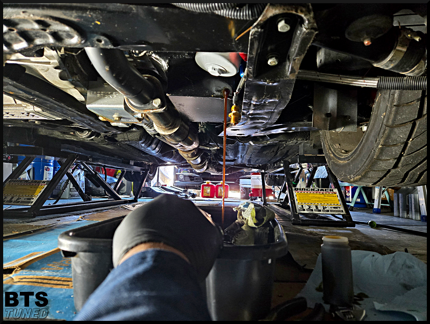

Taillight Tuesday! I took the Panda VR-4 on its last casual drive with TD05 this past weekend, and it FINALLY found its way back into the garage after many years of back-to-back builds for other close friends/clients. Eight years with the MHI EVO III 16G's with six of those for others to catch up here lol now v.4 can finally commence 😳 small window of time and still prioritizing wrapping up details with Tim's stroker showcar, soooo I will need to pick my battles with inspections, assessment, changes, and upgrades... starting with the usual and annual Blackstone UOA submission

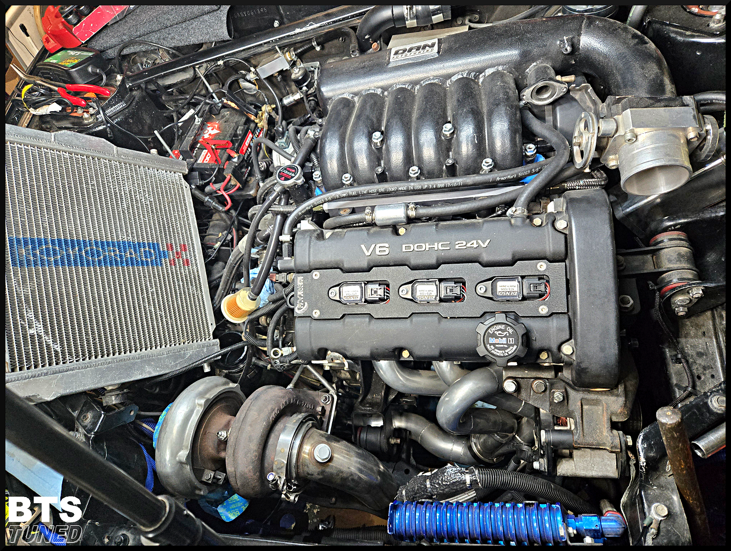

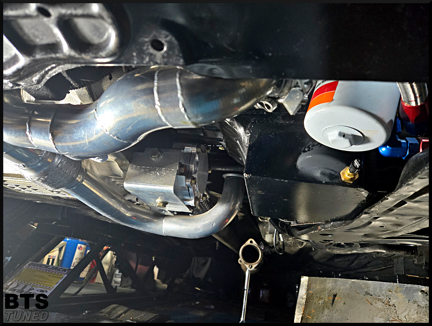

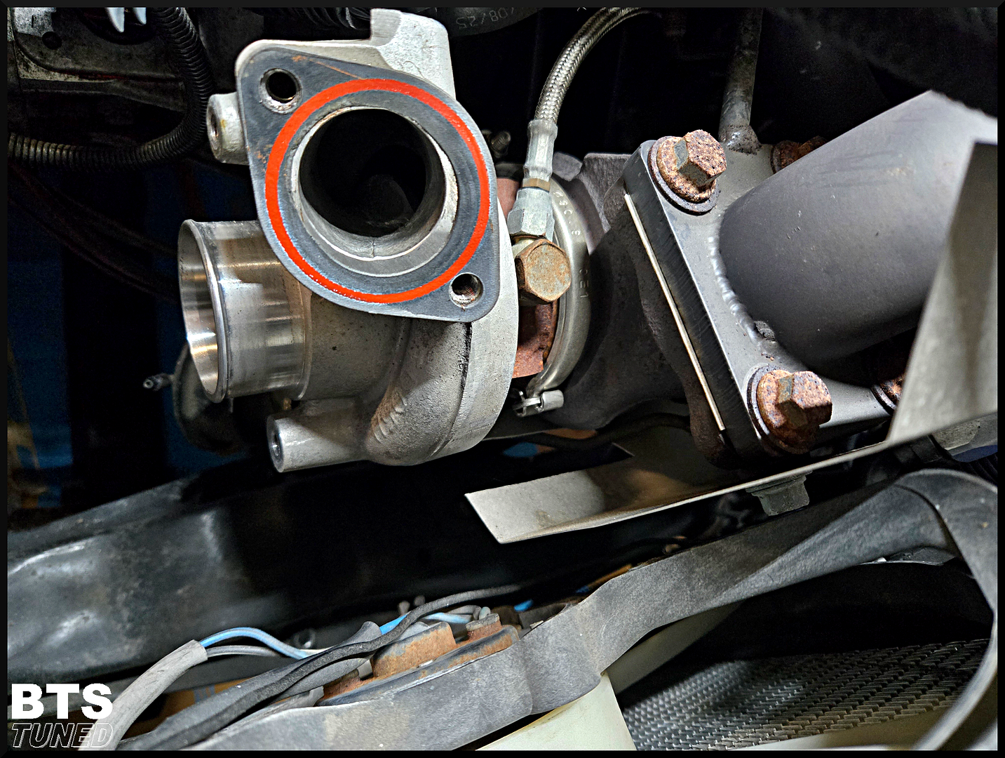

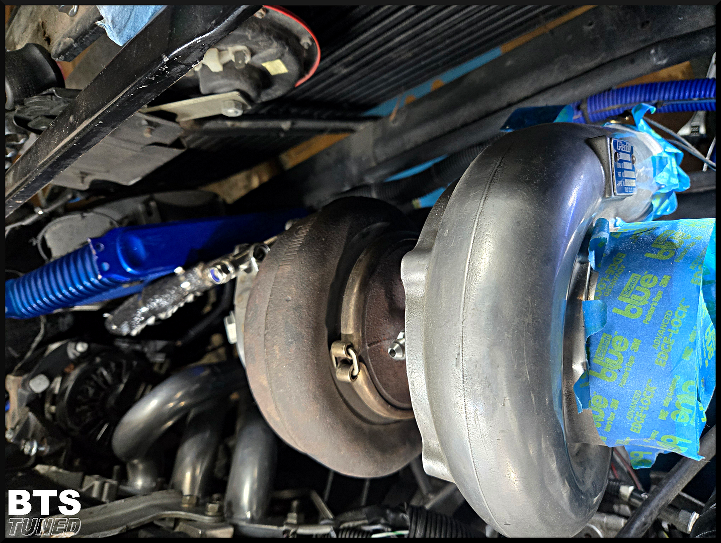

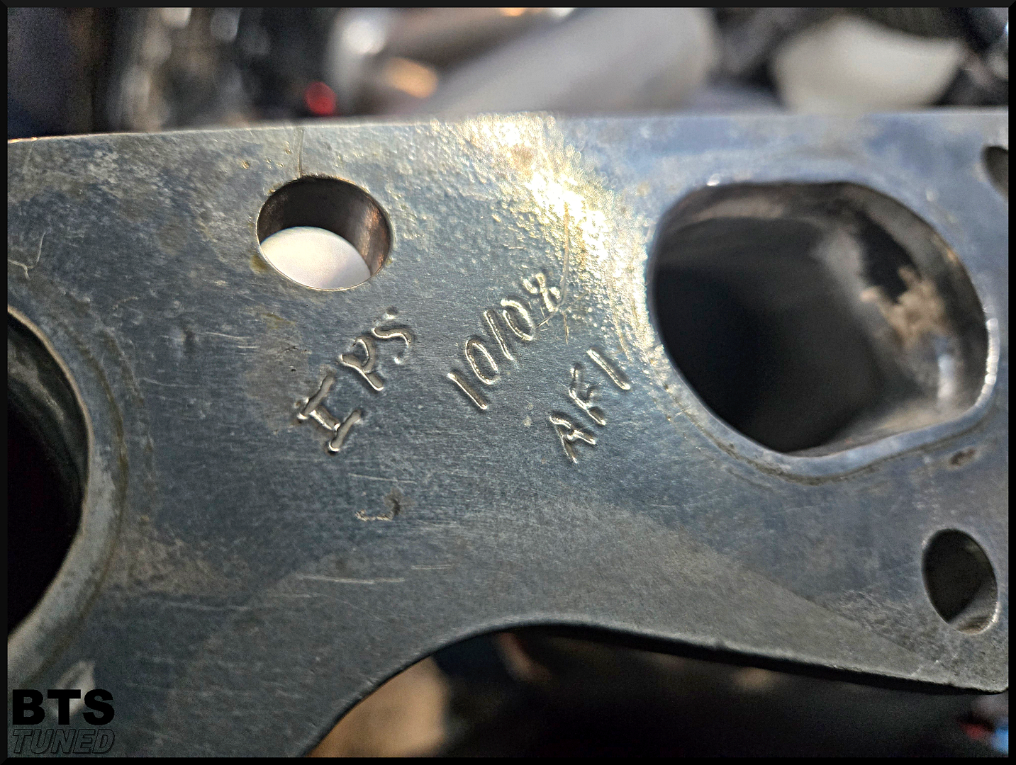

[Single] Turbo Tuesday! Mocked up the one-and-only new IPS hot parts with my GReddy T88 so that I could note clearances and changes for desired fitment+heat management...
all in good planning and execution. But man... seeing that patience come to fruition for Panda v.4 dream build since college days lol (not even counting mid-life crisis billet crank stroker build)
What a view!
Big ol' bastuhhhd
It only took 17 years to be finally utilized
thank-you for your service, new IPS TD05 w/ MHI EVO III 16G's

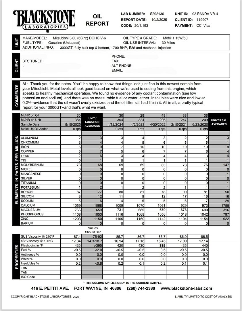

"Final" Blackstone UOA report for the Panda VR-4 v.3 on TD05
super extended interval at 17mos due to all of the other cars taking precedence plus family/dad life lol... extra confidence and reassurance going into the v.4 single turbo now
