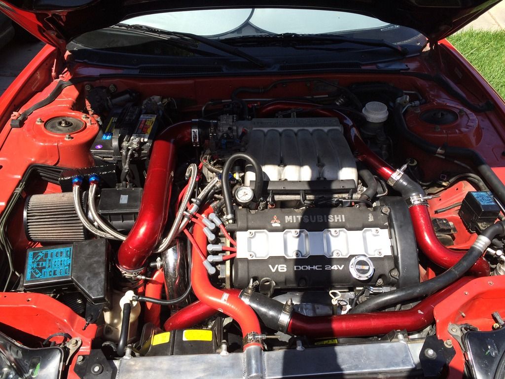

I have mine set up like this:
I have a small KV for the rear VC > OCC > intake bubble and a bigger one that replaces the PCV on the front VC. And yes i know the hose is too long lol.
So id be fine either running rear vc to occ then to bubble or u can Run Rear Vc to Air filter plug up intake bubble And neither of these cause Valve steam leakage cause of less vacuum?
If your engine is healthy, I don't see why there would be any problems by going with either method. If you have tooooo much oil going into your rear pre-turbo pipe/intake bubble then you might have an underlying problem.

I've got a pretty custom PCV setup so I'll just throw my setup out there.
Passenger side is Teed together from the valve covers then goes to a small Moroso Catch Can then a Dual Adjustable Billet Inline PCV to a Krank vent to the lower intake manifold. (Idle/Cruise).
Each drivers side valve cover outlet has its own 1/2" hose to its own Large Moroso Catch Can (2 of these) then one goes to the front pre turbo pipe and the other to the rear (Boost).
I used the other Krank vent as a check valve for brake/clutch boosters.
Not sure if you saw this but I'm liking my setup thus far. Keeps everything nice and clean. :) definitely a bit overkill, but it might give you some ideas. I like to have a catch can for vacuum and one or more for boost operation when in a stock like config.
