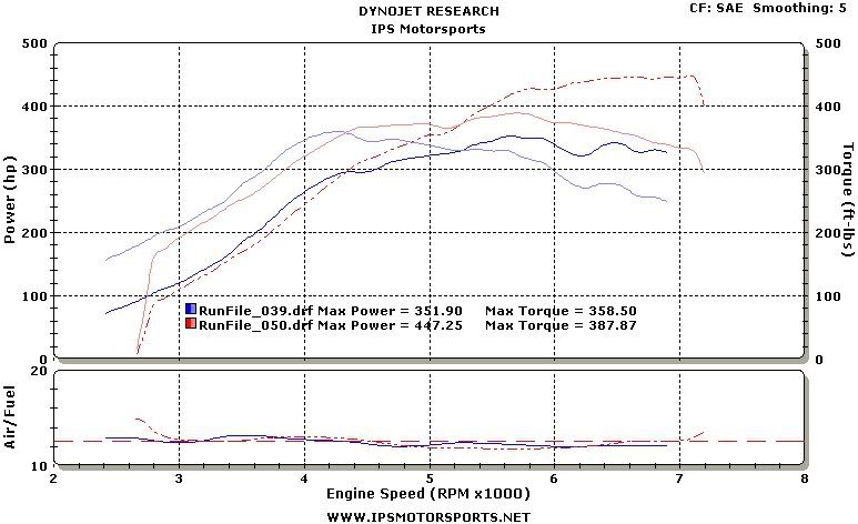

Wow, I guess seriously under-estimated the 9B's potential. Alright, so from here, where do I go? I am looking ultimately for 500-600HP to the wheels, street setup. Dynamic Racing's kits seem to be the way to go, the DR-800's or the 900's. Any other idea's for intial turbo upgrades?
DR650's or 15g's.....Thats what I would go with. Someone once said that 650 means 650hp I dont know if thats true or not but I am sure someone can jump in and correct me if I am wrong. The problem with the DR900 is that if I am not mistaken they are td05's and it requires a good amount of modification to install. Its all your choice thought. Do ALOT of searching and look at the thread that shows dyno charts, that should give you a good idea. Just dont rush into it and get something that you regreat later on.

The DR’650’R supposedly means 650hp crank horsepower but should make around high 400 to low 500hp on the dyno. DR900 are not MHI TD05 but Garrett T4/T3 turbos. Stock 9bs are not worth the hassle (believe me I know).
#10 ·
You wont get 600awhp out of any td04 you'd be pushing it for 500. Your going to want atlest EvoIIIs, or you defenitly can't go wrong with the DR800-1200

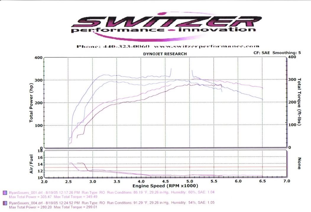

FYI the highest dyno on 9b's is 367 AWHP to date. The major difference in 9b power comes from those who have drivetrain mods vs those who don't (CFDS, lighter rims, aluminum flywheel). Those mods are not power mods but they reduce your drivetrain loss so the effect is the same (more power on the dyno).
One person will dyno 300 whp with 9b's another with a aftermarket clutch flywheel, and cfds will make more not from the motor but will get more of that power to the wheels where it counts.
