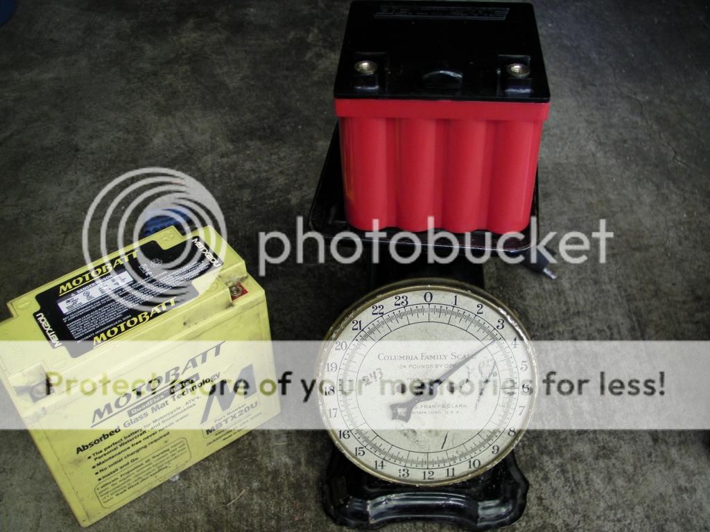

Maybe 2 at the same time? Pricey. I have to replace my Motobatt which has been completely discharged maybe 50+ times over 5 years :p Probably going to buy the same thing. My other SLA's (Odyssey/Genesis) were never revivable.

The Motobatt MBTX20U I have to replace went from $69 to $113-$128 dollars over the past 4 years. :(

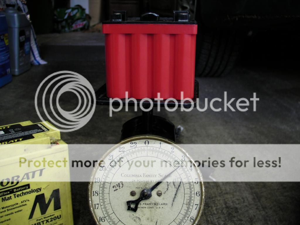

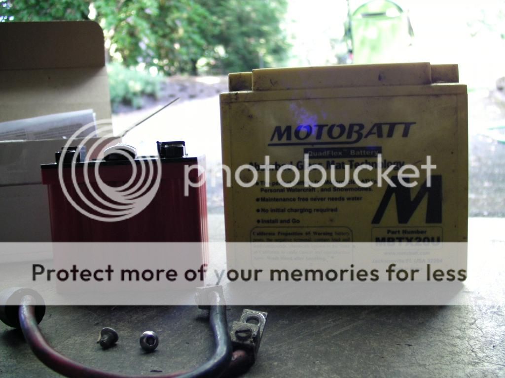

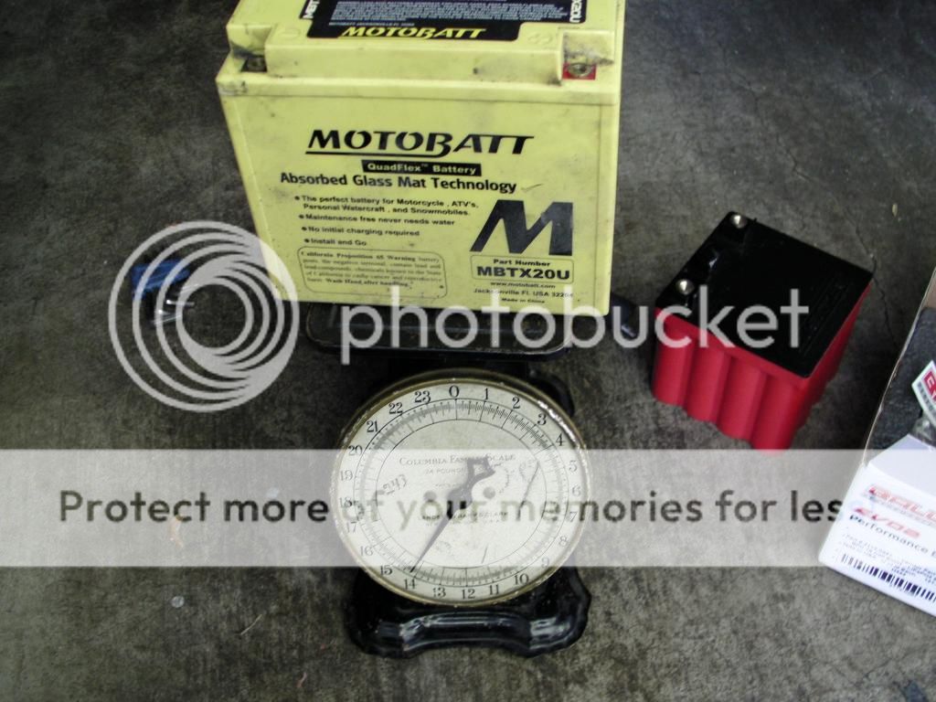

Now the 225 dollar battery that has more claimed cranking power, more capacity, and weighs 10 pounds less (easier to mount)...
I am more interested...

These batteries make a lot of sense for me, especially since I will have zero phantom draw when my car is turned off.
Easy to mount in the fender. No heat. No weight. More cranking power then my 14+ pound SLA that costs 115-130.
That and I found them for 212-213 shipped. Interested.

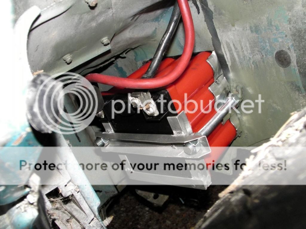

Its going inside the fender next to the frame rail just like my old 13-14 pound Motobatt.
Per NHRA it technically needs to be attached to the frame by a certain diameter fastener. I still have some all thread left over that is the correct diameter. I am thinking I need to weld on some nuts or something to really do this properly as I don't want to drill a hole through the frame rail.

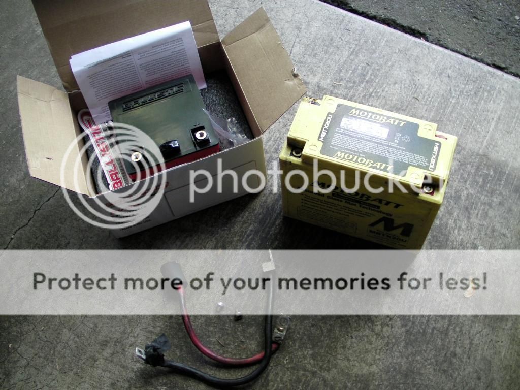

That battery weighs 24 pounds lol. No thanks. These batteries will start in very cold temperatures. All you have to do is create a draw and they heat themselves up, then start. That is why they are "rated" with a high CCA. In cold weather these batteries get stronger instead of weaker after the first attempt.
Have you got the battery? I'm about to hit buy it now lol.
Yes, its freakishly light. I was sitting on the couch with it in my lap and then thought "this is not safe to have around my kids" but it seems like one of their toys. Have not installed it but I am wanting to use aluminum.

Little bit grumpy. I had the bracket (brazed together) looking pretty nice and I saw something I wanted to make look better and I ended up melting the thinner aluminum top brace when I wasn't looking at what my torch was actually heating up. Fun to have nit picking turn into ruining something. Welding helmet is out of commission so getting the nuts welded to the car was quite the failure that required grinding. That and I didn't have a good ground etc.
I covered the friction points of the battery with B-Quiet sound damper as it was already getting chewed up from when it was hitting on the welds during fitup.

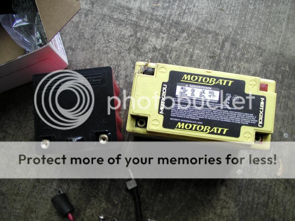

Hey, I got the regular 16 cell. I didn't need the HD (Harley Davidson) size or switched contacts. I did have to use a new longer power feed wire but it turned out fine.
