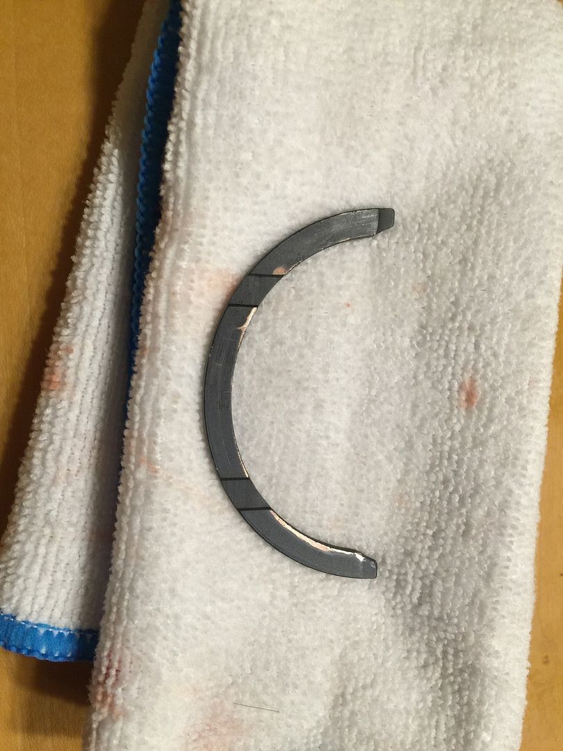

Purchased a set of coated Clevite bearing. I installed the crank and used the method Ray P. suggests to seat the thrust bearings (tighten girdle then loosen bolts 1/4 turn, tap both ends of crank to seat thrust bearings, retighten). Before installing any pistons/rods I had a last minute change of heart and upgraded to Ninja lightweight rods from stock so I removed crank to get it balanced. Upon removal noticed wear shown in pic on one of the thrust bearings - other 3 are fine. Crank had only been rotated by hand and plenty of assembly lube was used. Rotated smoothly.
I've ordered a new set of thrust bearings, and don't want a repeat. What should I do differently next time?

Hi Jim. Orientation: Coated side (black, grooved and face up in pic) facing outward - toward crank. Two of the 4 bearings had an ear/tab and two didn't (the one shown doesn't). Two of the recesses for the thrust bearings (one on the engine side and one on the girdle side) are cut to receive the ear/tab. The bearings with the ear/tab went in the recesses shaped to receive them.
I was able to get the engine side thrust bearings to stay in place while I placed the crank, but the girdle side thrust bearings kept falling out before I could place the girdle on the engine/crank. I used a little oil between the girdle/bearing to keep them in place during assembly. The oil on the girdle side of the bearings was in addition to the assembly lube I used on the crank side of the bearing.
If there is a better way to retain those girdle side thrust bearings during assembly I'm open to suggestions - don't like putting anything between girdle & bearings as it could impact clearances and increase odds of bearing spin. Guess I could have stuck the trust bearings to the crank with the assembly lube and then placed the girdle - would that be better?

I take it that that washer was in the girdle. Sometimes they get cockeyed during assembly. I hold them from the sides with my thumb and forefinger as I lower the girdle onto the block. I also have the crank rotated so the counterweights aren't in the way.

Yes, it was in the girdle. I'll try the technique you describe when I put the new ones in. Thanks.
