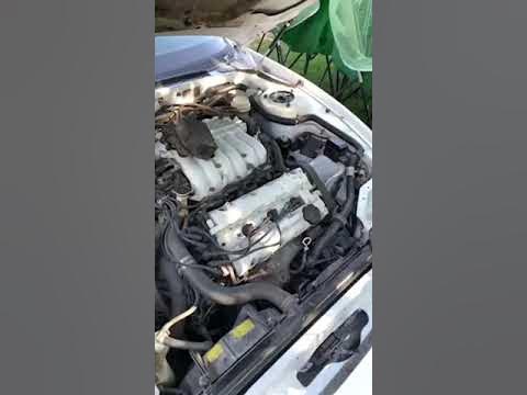

Hi
I have a 1994 sl and i have problems with it since spring. Engine is rattling/knocking ( link to a video showing this sound below) when you rev it, this sound is mostly noticeable at around 3k rpms at top of the engine. This problem didn't appear year ago when i bought it, then it was only missfiring at one of the cylinders when mass airflow sensor was plugged. During winter i have completely rebuilt front and rear suspension, fixed the steering rack because it was leaking, sanblasted and painted everything. Then when i drove the car out of garage in may it started to make this sound and i couldn't track source of it since then.
I have checked under both valve covers and everything seemed in order, then I checked cylinder pressure and every one of them is good, but one of the spark plugs had some white deposit on top of it. Timing is also good and every pulley was checked and none of them was making weird sounds
Link to the video
youtube.com
Link to the video
