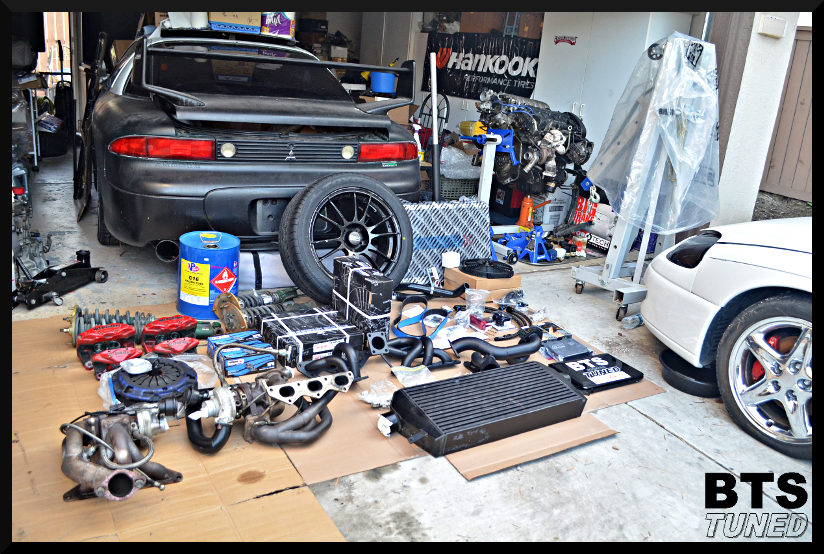

Without further ado... preview pictures! I used my vacation from work last week to get the ball rolling.
The madness awaits...

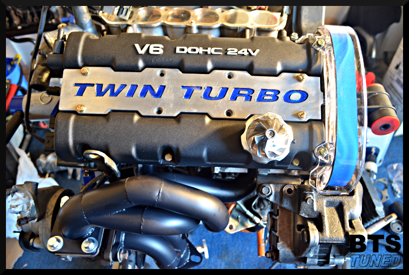

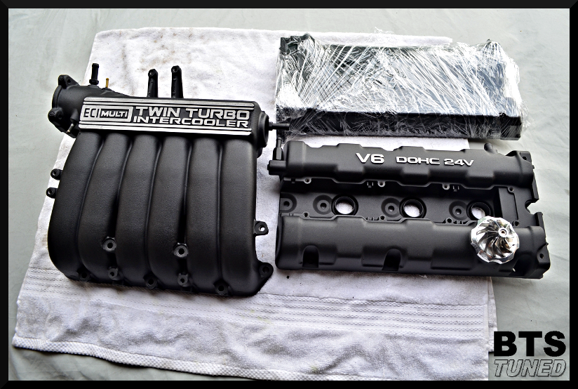

Wrinkle black PC'd goodies for a more subtle look underhood

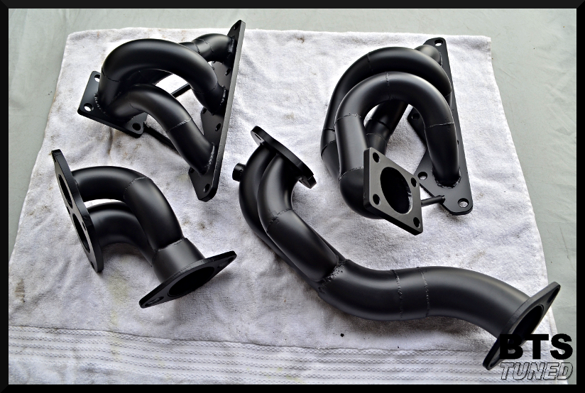

2000*F cerakote-coated brand new IPS TD05 manifolds + housings

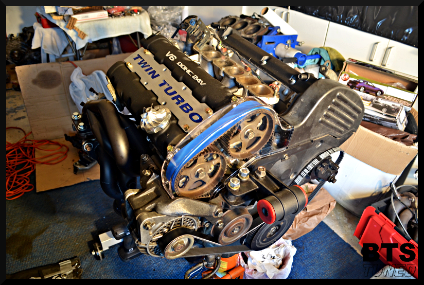

4-bolt is fully assembled, timed, and prepared to drop-in!

A little preview video clip (not all parts are shown) prior to cleaning up and organizing for surgery:

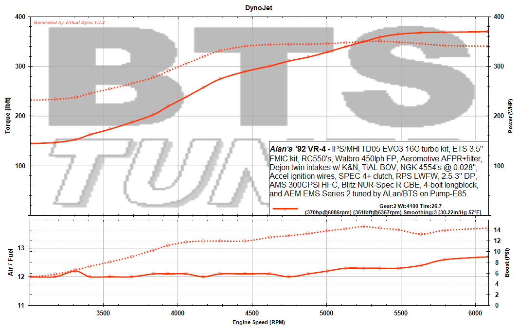

//edit// 12-22-2017 updated
Panda v.3 VR-4's initial tuning numbers! 370AWHP VD SAE (~480bhp) at WG 11psi creeping to 14-15psi, CONSERVATIVE 13* timing, and 100% maxed RC550's on Pump-E85 haha! Awesome power potential from the get-go... another 10psi should land me deep into the 500's - yee!
Next step is ironing out some details with various improvements and shoot for 450-550AWHP. Final efforts will be 550-600 or wherever I end up as icing on the cake lol! Once I overpower the current tires, I will get some 275 or 285mm extreme summer or competition tires mounted on my Gram Lights set.
