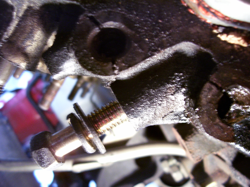

10/07/06
Pulled and dissembled the heads. And dropped the tranny. While dropping the tranny the drivers side motor mount (the cracked one) broke out of the block and a nice chunk fell. Definetly made me jump as I was under the car at the time. Also made me glad I found this crack now, and not some time while driving. I'm lucky it never gave away at some point over the last 7 years.
