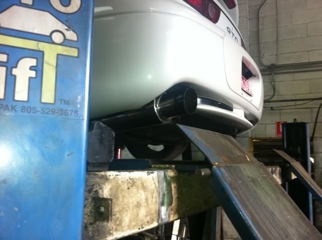

Car isn't modified as much as everyone else's but its got the power I'm comfortable with for now :)
Car: Mitsu GTO MR '96
Mods:
Engine:
BIG FK OFF Saber FMIC :D custom piping
Custom CAI
Manual boost controller
Turbosmart BOV
Some Pod filter that works
Fuel pump relay bypass
Factory speed limiter overide
Kakimoto single shooter catback exhaust.
Driveline n suspension:

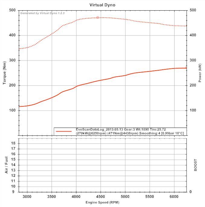

Yeah good results. The E-manage is an interesting thing, a lot of work goes into these early stages. Mid to low 11s AFR very conservative timing, 21 degrees peak. Before we reduced it timing was close to 30* and were getting some knock. Now has zero knock. Looking forward to the next stage.
14.5psi peak tappering 13.5psi I love the feeling of a nice tight engine anyway heres a VD print.

That pull in timing is required to keep it at a safe level due to to the airflow(Hz) being clamped to avoid fuel cut I could only do this based off TPS as you didn't have the boost sensor installed at the time. I'm tempted to say drop your car here with your boost sensor and meth kit and I'll give it back with 350kw.
