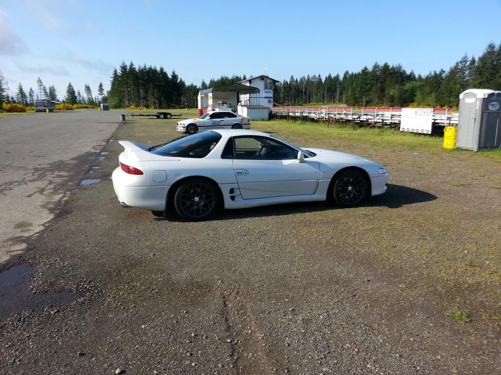

I only took one pic of my car at the track.
