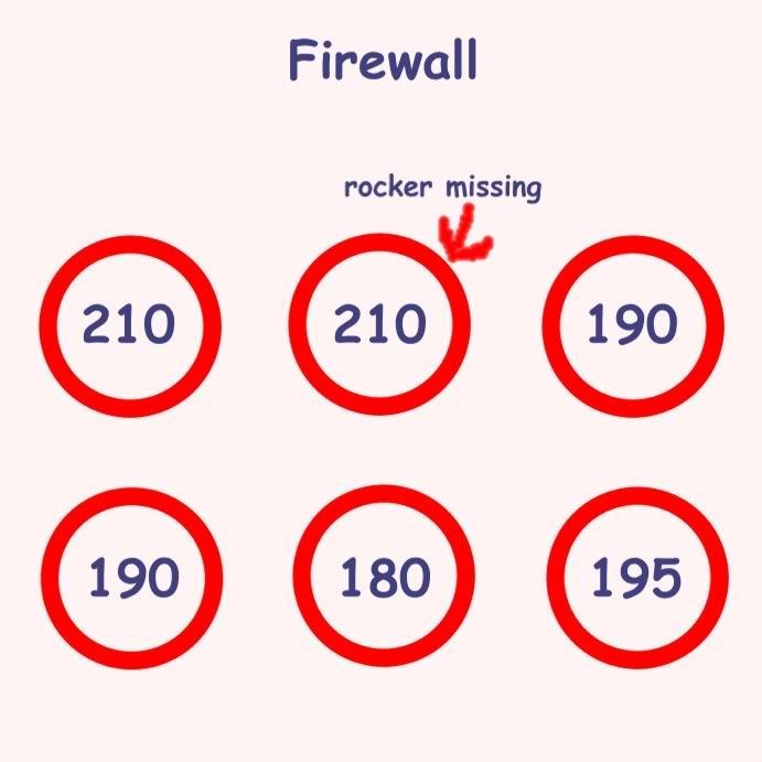

Originally Posted by jacob666 View Post
Good news so far
So it appears no bent valve
Sorry for the late reply, but your compression is really high. Your compression should only be 185 according to Checking Engine Cylinder Compression on a 3000GT (6G72)
alright what should i do? and what could be causing this? and is there any danger?

I'm still trying to check if those numbers are right. I'm getting conflicting information. Some say it's supposed to be 210 (in which case your cyl #3 if fubard) yet supercar says it's supposed to be 185 in which case you probably have carbon buildup. It's essentially raising your compression ration but lowering your displacement. I believe Seafoam would help get rid of some of that carbon.
I've done seafoam once, could do it again tho couldn't hurt.
and so if you take the average of the reports i'm about right lol.

if you can get matt to log your car, see if you're knocking or pulling timing. This seems to be a mystery for some reason

Shop manual says 185, so I'm gonna have to says your compression is ridiculously high. The best way i can think to deal with that is to pull the heads and clean out all the buildup, but I imagine that's not something you'd wanna do.
