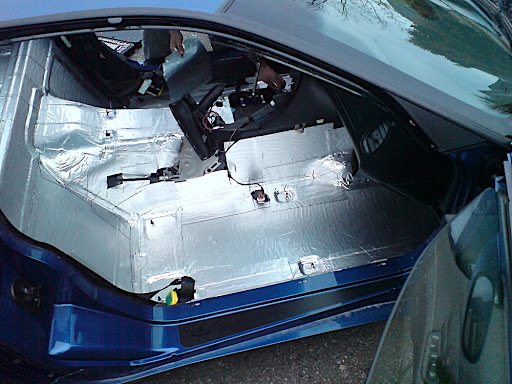

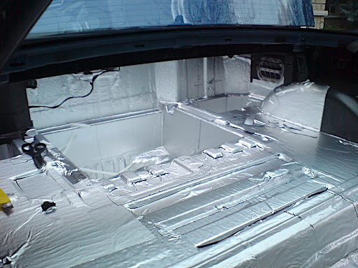

Default Re: best sound deadening for the price

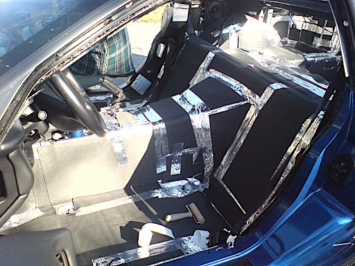

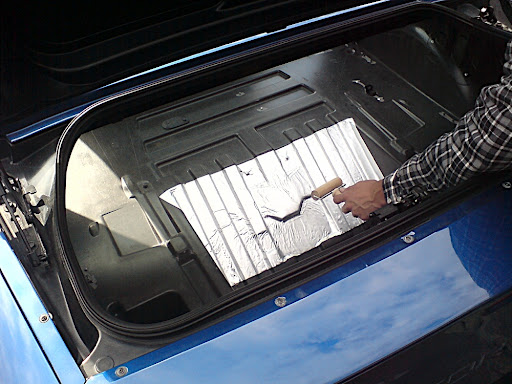

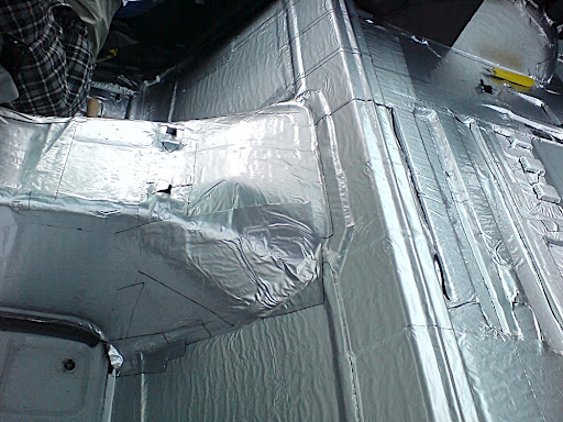

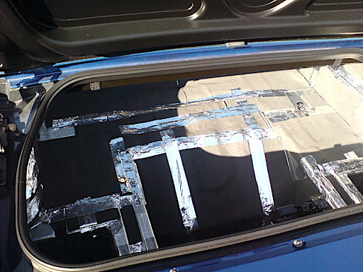

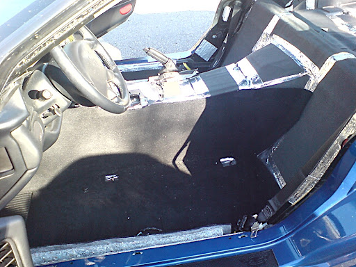

I did my friends Z06 with stuff from here (apparently Corvette Forums all go to this guy): Elemental Designs
Came out great. From the inside sounds quiet as stock. Dont forget the doors and the trunk lid.
That was the thinner stuff. Probably would have been enough, but the OCD kicked in, and we threw another layer of the thick stuff for the low frequency too. All seams sealed with aluminum tape. Carpets fit back in fine.

Looks nice. Funny about the OCD since I know what you're talkin about. After 4 layers I was like eh its already apart another probably won't hurt. Times that by every panel that got done.
This is one project that needs to be done, but really suck to do, IMO
