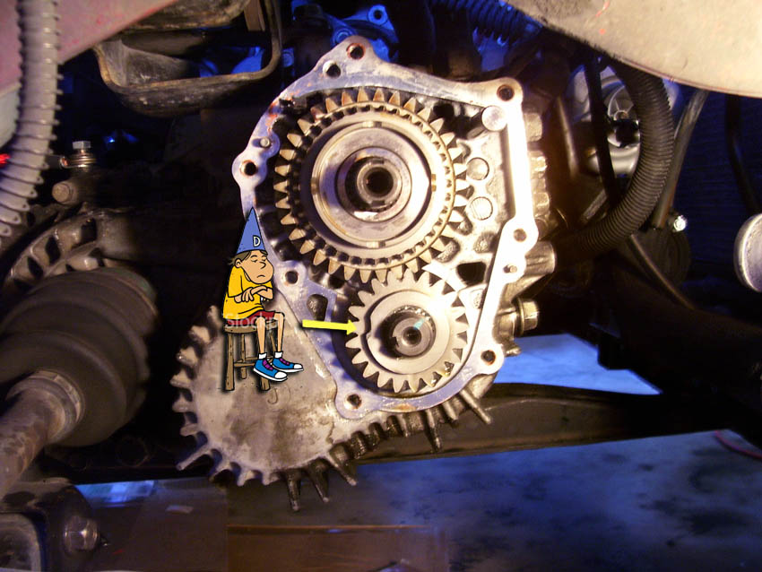

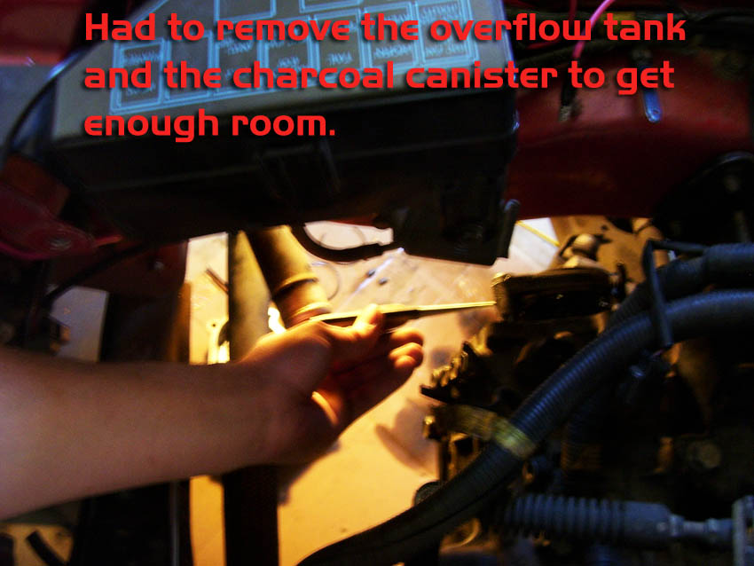

Spent most of the day with the car, though a good portion of the time was spent running back and forth to parts stores to find the right tool I needed. I hate wasting so much time doing that, but it is all part of the game.
On to Transmission work day.

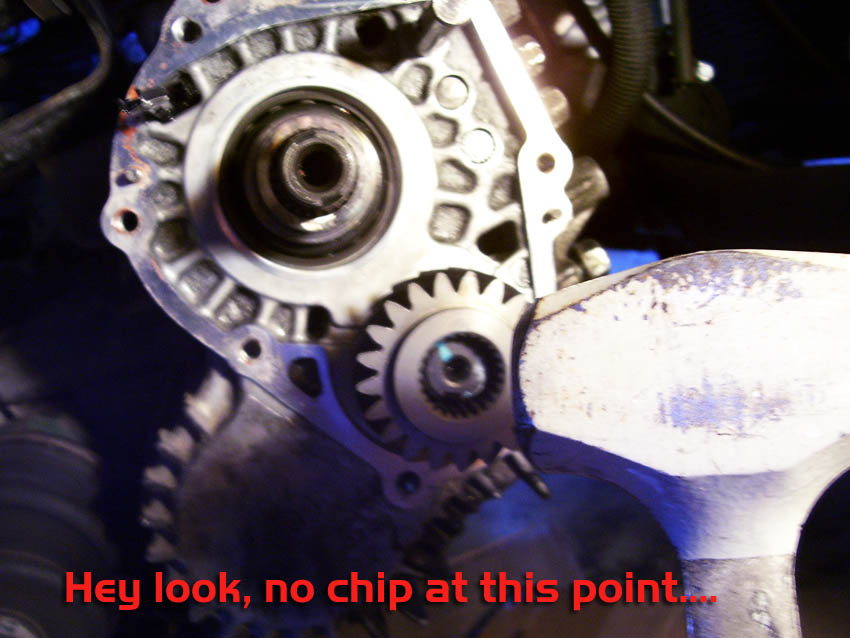

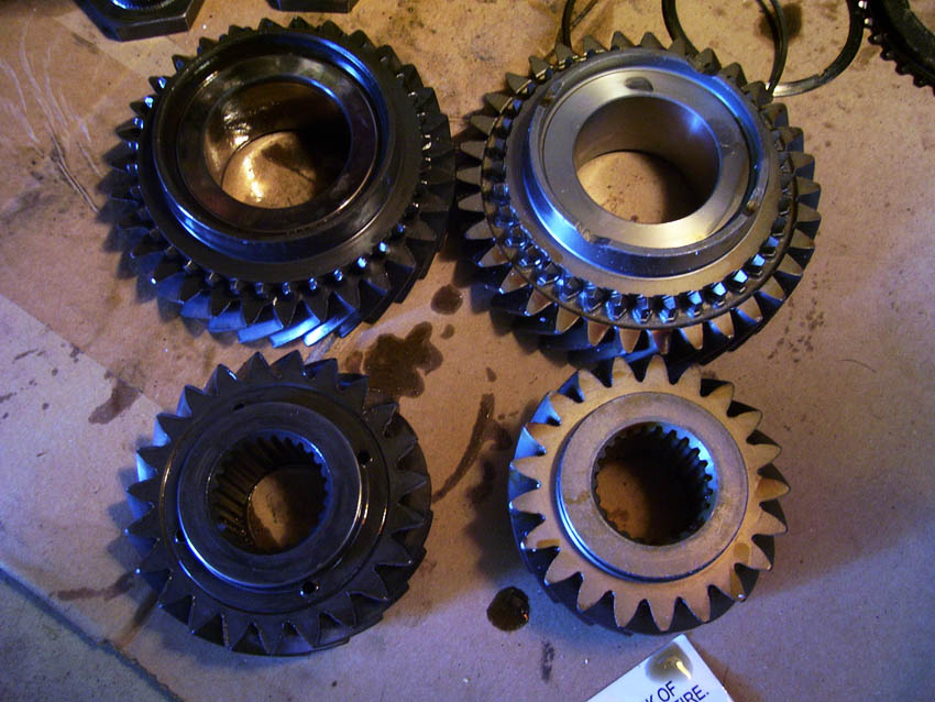

After I got everything apart, thankfully nothing aside from the reverse gear synchro.
Noticeable size difference between the two gear sets.
Though following the rules of Murphy the new gear went on and then decided to no longer slide. So I had to bring out my special tool.
I never said the special tool use is always a good idea.
Well, everything is put back together for the most part, though I've been looking and am getting some conflicting numbers. What are the torque specs for the end gear nuts?

Oh yeah, but at that point I had already been to Orilley's twice. I should have gone a third time.
Originally Posted by defyboy View Post
Ohh I hate it when you do something like that... then you think of the consequences when its too late.
Yup, I had a thick fold of shop towels to cushion between the sledge and the gear. I didn't even know it broke until I finished tapping it on. Then I cursed... a lot.
