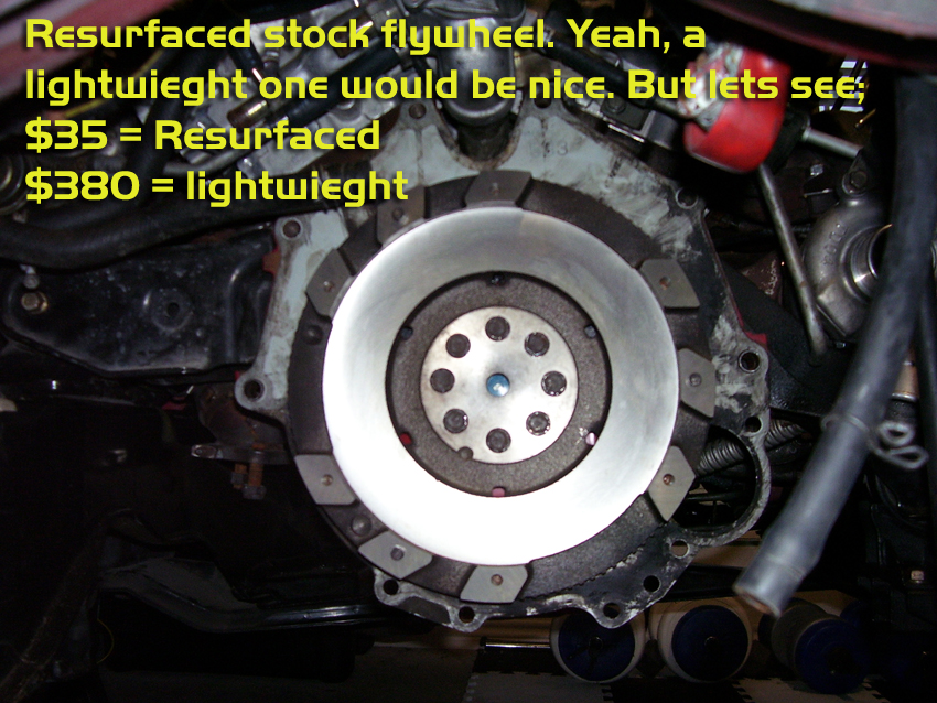

1/12
After I got out of my classes it was time to start.

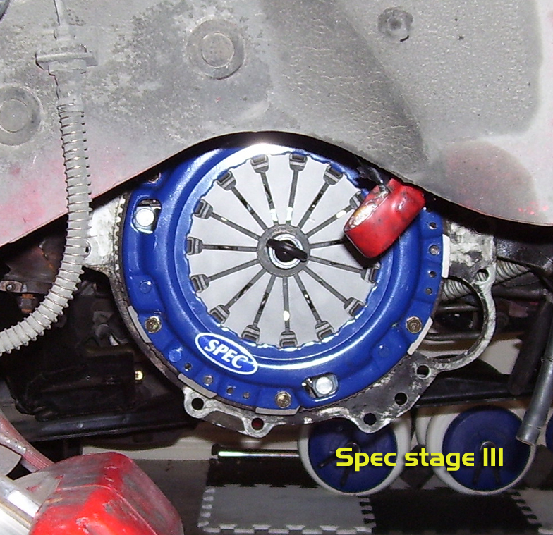

I headed over to Jeremy's, first order of business, mount up the clutch. To start, Flywheel time.
Better take in the pretty blue, last time that will be seen for a long time.
Everything went up fine and easy.

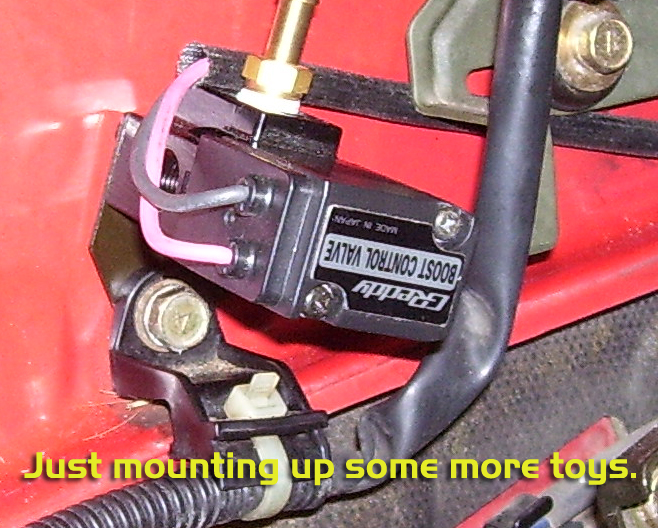

Then we mounted up the solenoids for the electronics and routed the vacume lines.
