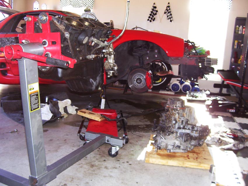

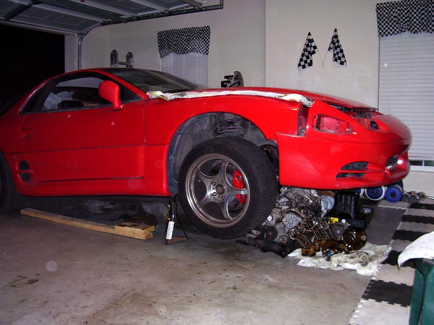

10/07/06
Pulled and dissembled the heads. And dropped the tranny. While dropping the tranny the drivers side motor mount (the cracked one) broke out of the block and a nice chunk fell. Definetly made me jump as I was under the car at the time. Also made me glad I found this crack now, and not some time while driving. I'm lucky it never gave away at some point over the last 7 years.

Dropping the engine was an experience, I'm only going to rent a cherry picker when I install the new one, so literally dropped the short block out of the car, it was only about 5 inches onto a crawler, but it was still a pain in the ass.

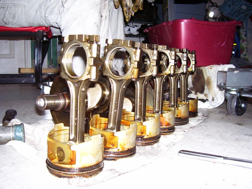

Set the old block on the engine stand and got to tearing it away.
I'm going to reuse my 2nd gen crank and rods with new ROSS pistons.
