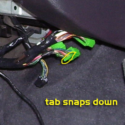

again does anyone know how the ECU plug comes apart? I just don't want to break it. that would suck.
thanks,
Paul
There are different plug setups I've learned. Mr3000 and mine are different.
Mine is the bright neon green one. If yours is like that there is a locking tab on one side that pops out.
Here is the best picture I could find of my ECU plugs.

OK I have the green plugs like yours. (just to clarify what I am asking) that I have the ECU out but I need to remove a wire from one of the plugs then put it in another pin hole for the other O2 sensor. it looks like the plug pops apart but I am not sure how it pops apart. do I just pry it apart with a small screw driver?

The long edge pops down, I did break one of them when snapping it down.
And you can pull the metal pins out with needle nose. It sucks, you may mess one up. If you do you can get new ones at radio shack.

thanks I just don't want to mess up the plug then have little ecu problems because it is not making a good connection.
