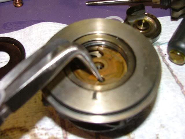

I removed the clamp first. It makes the big snap ring easier to get to.
I had to pry a little to get them apart.
Since they don't seem to sell a good pair of large snap ring pliers around here I modded a pair of pliers with a grinder and it worked pretty good.
