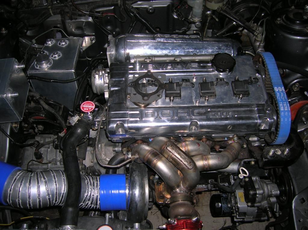

Got almost done putting my DSM together im a few hrs from starting it here is the mod list and some pics I had this car since 99 ran for a few year and was sitting down for alomst 5 years im so happy is back together is a shame I wont enjoy much , I got a buyer ready to purchase then again more money for my Stealth r/t Build
Engine
2.1L 10:1 Malhe Pistons
H beam rods
Clevite bearings
Nitrated crank
Stage 3 GCtech head port
Crower 280 cams
BC spring/titanium retainer
GCtech intake manifold
4" bar/plate intercooler
Holste HX40 t3 .86 turbo
GCtech turbo manifold
3" downpipe
3" aluminium exhaust system
N1 Apex 3" muffler
Evo 8 ECU Swap
PTE 1000cc injectors
Multiport Ethanol injection 70/30 mix
GCtech 65mm bore 3000gt vr4 Throttle body
GCtech 6 point roll bar
2g Vr4 front brake swap
Custom Dupont Dark Gray paint job
[IMG]http://i1121.photobucket.com/albums/l511/gctechpics
/DSCN5494.jpg[/IMG]

Got enough pie cuts there for the intake?
haha I know, 4" bend was not tight enough to clear so OLD SCHOOL pie cut technique hehehe

Yeah you better be in a comfortable position because you'll be welding for awhile on something like that. Lol. I hope I don't have to do something to that extent. I would like to learn to TIG though.
Not really I weld standing up and that took less than 30min to do.. if you dont have the need for 4" you can get anything from 2-3inche in tight radius so you will be fine.
