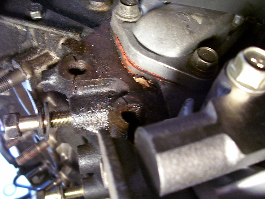

I go to put back on the motor mount, check the torque settings and go to torque it down. Just as it is tightening up it becomes loose, OH CRAP, I see a little bit of water drip out from behind the mount. When I back it out I find this.
Nice I know, and look at the one above it.
To give you a better idea of where you are looking.
So not only is the block cracked, but the lower hole is cracked enough to leak from the water passage. ARG! Also after looking closer I found why the block felt smooth where the Reamer bolt was supposed to go, that was because it had been broken off in the block. Oh the joys of being the 3rd owner of a car.
I was documenting the work, a lot of pictures and all, now that I am looking back through them I can see the cracks in the block had been there for a while, so basically when trying to torque down the engine mount became its death sentence. I suppose it is always better now than later but it still sucks.

I agree you may as well do a tt block since it's never a good idea to put used pistons in any block besides the one they came out of. I assume your heads will bolt up fine since i put tt heads on an na block when i did the conversion.
As far as how the cracks happened i can only draw 3 conclusions
1. Your car was wrecked at some point
2. That motor is not the original and came out of a wrecked car
3. Not having the reamer bolt put too much stress on the remaining 2 during it's lifspan of being mounted that way, (too many hard launches?)

The car was wrecked by the first owner, it was a drivers side collition, so this mount would have taken the first blow. I'm just wondering why it was never an issue until now?
That does make sense, she didn't see many hard launches in the 7 years I've owned her as I never took her to do the 1/4.
But I have been autoXing her for the last 2+ years, so I guess I should be considering my self lucky that I found this problem while doing work instead of out on the road at some point.

It's been an issue since they cracked, it's just that your the first one that cared. Whoever did your belt last time is a jackass for not telling you about it and just putting it back together "just tight enough to hold"
