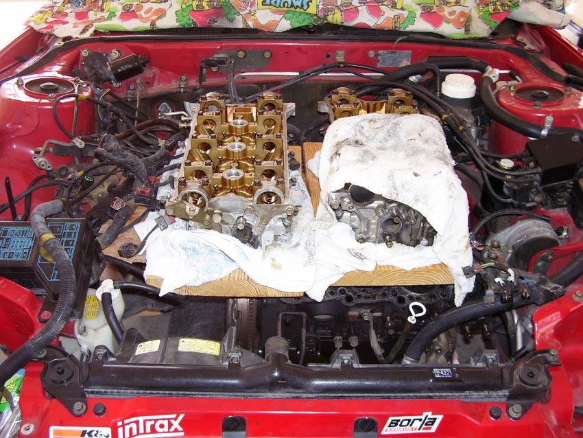

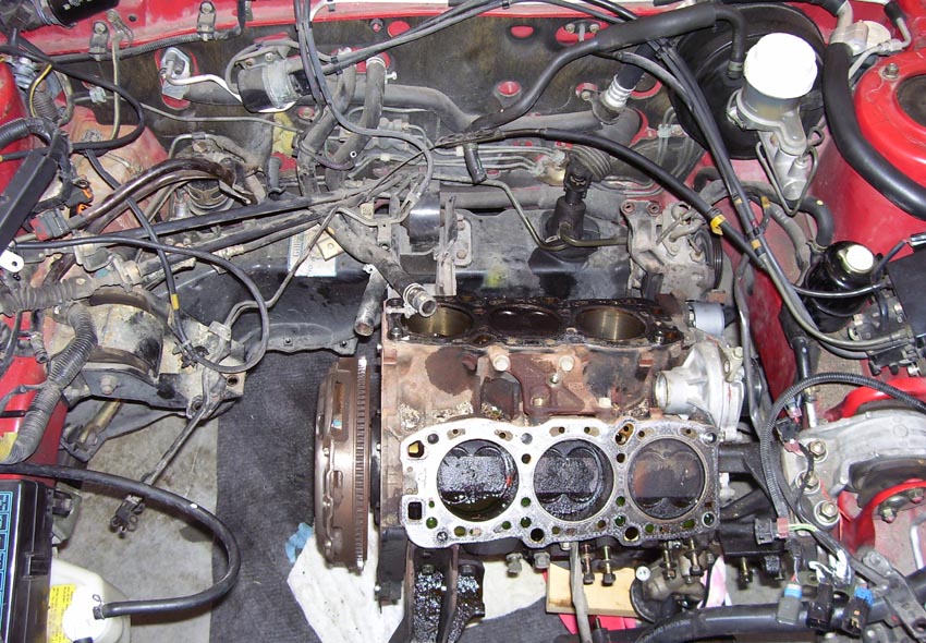

Pulled and dissembled the heads. And dropped the tranny. While dropping the tranny the drivers side motor mount (the cracked one) broke out of the block and a nice chunk fell. Definetly made me jump as I was under the car at the time. Also made me glad I found this crack now, and not some time while driving. I'm lucky it never gave away at some point over the last 7 years.

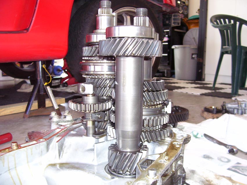

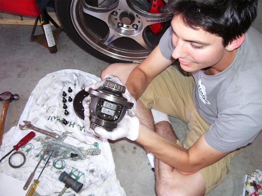

Took apart the tranny and installed the SFR LSD insert. This was the project I was most worried about. I was at the point of taking it to someone to install. But thanks to some of the guys here and a walk through from the DSM boards Jeremy and I did it our selves. Definitely a lot easier than I had originally thought it would have been.
